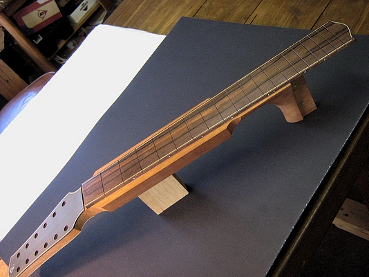

G'day Craig. That's a fine lookin' neck you got there. Did you have some
long pieces? I've got a bunch of reclaimed piano keys, but it would take
quite a while to cut them all up and prep.
PostPosted: Sun Sep 16, 2007 10:59 am
Posts: 720
Yep Mike , it takes a lot of mucking around . Just one other reason it takes me thousands of hours to complete a guitar.
Key tops are graduated in thickness (front to rear),about .7m.m. to .5m.m. ,so you have to thickness them , which isn't easy when they are so short.
On top of that , nearly all of them will have hollows worn in them from the pianists fingers.
As a piano tuner ,I have quite a lot available and choose the tops from the very treble and bass ends of the keyboard ( less wear ).As Ivory comes in various colour shades, I take them off the same keyboard to keep the whole thing uniform in colour.
It's worth the effort ( to me anyway ) as I can't bring myself around to using plastic ,and hey! ,I've got ivory purfling !
